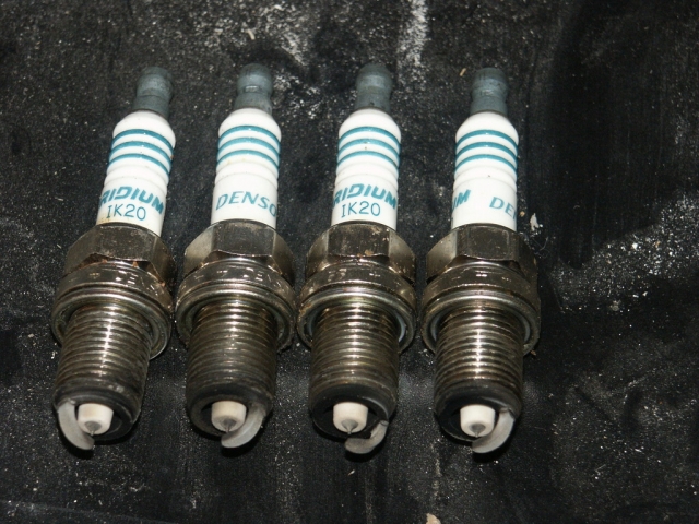

The first set of plugs were the standard V groove NGK. Under some heavy driving the spark plug tip wore down quickly – so it’s not an option.
The Type R uses cold range 7 plugs and the RS uses 6 so we figured we would stick with these and data log from there as a base.
The Denso IK20 is bascially a NGK range 7 plug (temperature ranges vary from manufacturer so you do have to do your research). Starting with a colder plug and the iridium core having better heat temperatures this would provide (in theory) a base for us to log data.
