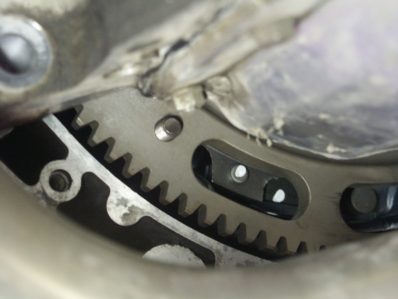

After the season the Exedy clutch packed it in… or so I thought…
The clutch looks good with no damage or discoloration and the springs look good. I was expecting all three issues as the clutch just slipped under boost.
And then we looked at the pressure plate which looks like it has seen better days (Sorry, I forgot to take picture of the arms which are out of spec).
