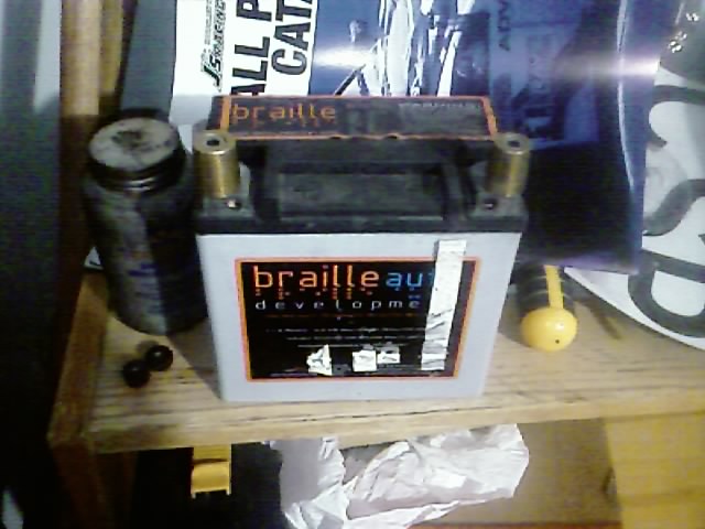

The battery I went with in the end is Deka ETX20. Funny thing is that the specifications are exactly like Braille.
Cost $120 from East Penn (Manufacturer for Deka) in Calgary.
The new battery compared to the old battery.
By the numbers:
Weight:
  • Power Connection Battery: 24.4 lbs
  • Braille B2015 = 15lb = 425 Cold Cranking Amps @ 0 degF
  • Deka ETX14 = 12lb = 200 CCA @ 0 degF
  • Deka ETX20 = 15.5lb = 270 CCA @ 0 deg F
A shout out goes to Neal H – Thank you for the terminal ends. I couldn’t find any stores that carried this item stock (M6 terminal ends seem to be a special item). The local battery shop would run a special order @ $30for a $6 part 🙁
